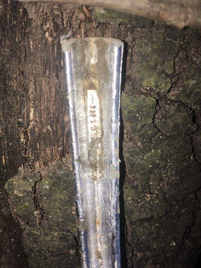

Here's a small handle I also found at the wreck site. It has a partially legible part number:

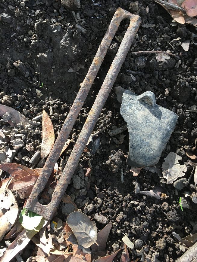

Here some more pieces from the wreck site

Notice also the wrapped and soldered control cable. The bracket attached to the cable looks like it may have been part of a wooden aileron. This suggests a pre-WW2 aircraft, but that cable splicing method could have been used for a repair part.
https://nc3397.blogspot.com/2011/01/flu ... wires.html

I was thinking of a civilian aircraft built for the military, surpluses soon after and given a splash of civilian paint. The tubing looks like landing gear to me. The handle is a great clue.
