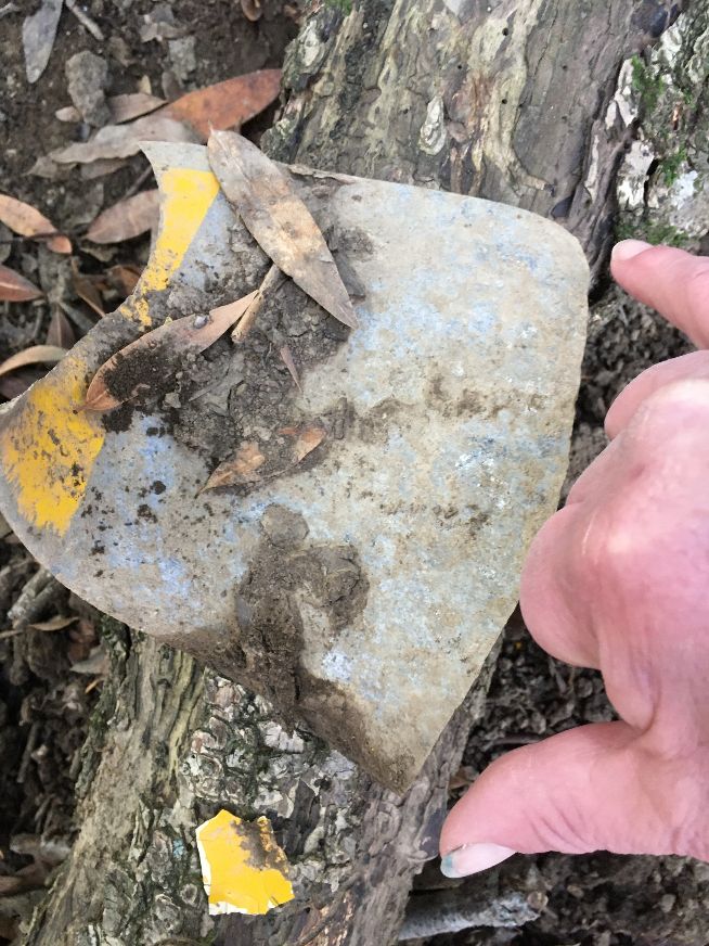

While out hiking last week in California's Bay Area, I stumbled across a very old plane wreck site. It most likely was civilian and most likely occurred in the late 1950's early 1960's time frame and the site appears to have been cleaned up, but on multiple remaining pieces of the wreck is a coat of silver paint as used on military aircraft of the 1940's & 50's. Below the silver is a coat of tan paint. Overlaid on top of the silver are red and yellow coats of paint. The coat of silver paint suggests it may have been an aircraft requisitioned during WWII. The remains at the crash site indicate a radial engine, steel tube fuselage and fabric covered wood wings. There are multiple small pieces at the site and it looks like the aircraft hit the impact site hard and evidence inidicates it was a fatal wreck. The site is in a regional park but the park archaeologist has no record of it, and there are no NTSB records of this crash going back to 1962(the earliest year records are available online).
I've posted photos below hoping the hive mind here on WIX could at least figure out what type of aircraft it is. Thanks for any and all help!

Don't discount the possibility that the silver was a primer.

I've thought about silver as a primer coat. That is possible. It is on top of a light tan coat of paint. I also found other small paint chips that had a deep blue on top of the silver which might have indicated insignia blue (or a more complex civilian paint scheme).

I can't help with an ID, but the red and yellow paint makes me think water bomber of some kind. Just a hunch.
PostPosted: Mon Jan 18, 2021 2:35 am
Posts: 5767
If you are thinking it is a civil type used (impressed) into military service, How about this...
Navy trainers had lots of yellow.
Instrument trainers had red bands.
So how about a Howard GH/NH a type often used as instrument trainers?
If that piece of cloth is an interior piece and it was a military aircraft at the time of the crash, the color would suggest a former civil ship, I would have thought a purpose built military AC would have a darker interior.

Notice also the wrapped and soldered control cable. The bracket attached to the cable looks like it may have been part of a wooden aileron. This suggests a pre-WW2 aircraft, but that cable splicing method could have been used for a repair part.

The picture of yellow vinyl appears to be interior trim. There were several small pieces scattered around the wreck site. I think it is a post-war crash as there is a suitcase tag belonging to a woman who lived in Fresno, CA at the address indicated from 1952-1956. She was not killed in the crash (and I don't think she was even aboard) and passed away in 1988. There's also an Avon lipstick tube and a women's wristwatch. A Howard DGA is a possibility. I haven't been able to match up the piece of steel tubular fuselage I found to any photos of DGA fuselage. There are sadly still human remains at the site...

I was thinking of a civilian aircraft built for the military, surpluses soon after and given a splash of civilian paint. The tubing looks like landing gear to me. The handle is a great clue.
