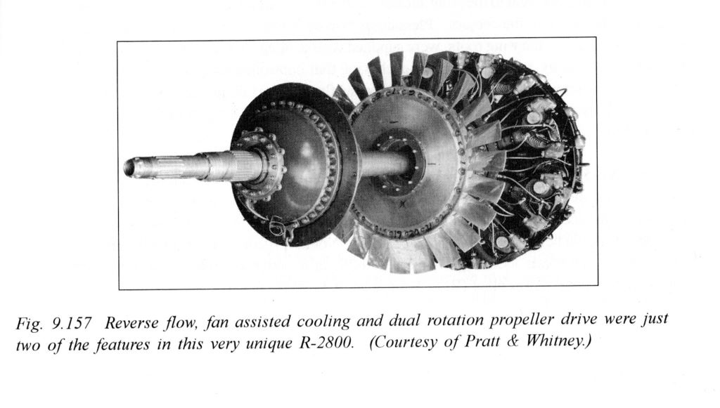

The R-2800-29 used in the XP-56 does not look like the engine in the photo. If you have a copy of R-2800 Pratt & Whitney's Dependable Masterpiece by Graham White there are pictures of that engine from the rear (p. 264) and front quarter (p. 539) which shows a large fan and extended prop shaft with a gear box. If you look in the index under R-2800 (general) for the -29, there are more references.
I will try and scan these images and post them in a short while. It doesn't answer what the engine in the photo in this thread was or why it has the long nose extension.
Randy

What I can learn about the engines used on the XB-28. The same book I referenced above says that the XB-28 used 2800-11 engines and the XB-28A used 2800-27. On page 531 there is a data block for the XB-28 that says the right engine was a 2800-11 and the left a 2800-15. Page 255 has the specifications table for the -11 and under notes it says "Left engine was R-2800-15. Torque indicator experimental. XB-28A crashed". Page 256 has the specs for the -15 with the note "Right engine was R-2800-11. XB-28A crashed. Similar to -11 except counterclockwise rotation". It shows only 4 of the -11 manufactured and 3 of the -15.
On page 262, the data table for the -27 says a total of 878 were built. The Applications block says "Douglas JD-1, Douglas B-23, Douglas A-26, B, C, Douglas XA-26A, B, C, Douglas XFA-26C, Fleetwings XA-39, Grumman XF6F-1, Grumman XF6F-4, Grumman F7F-1N, North American XB-28A". I didn't find a photo of any of these dash numbers. Just FYI.
Randy
