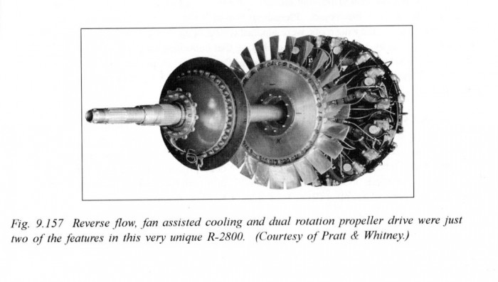

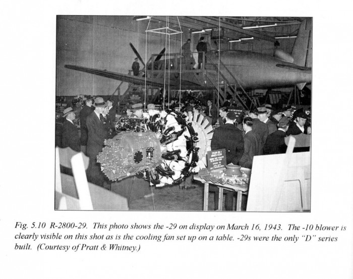

The R-2800-29 used in the XP-56 does not look like the engine in the photo. If you have a copy of R-2800 Pratt & Whitney's Dependable Masterpiece by Graham White there are pictures of that engine from the rear (p. 264) and front quarter (p. 539) which shows a large fan and extended prop shaft with a gear box. If you look in the index under R-2800 (general) for the -29, there are more references.
I will try and scan these images and post them in a short while. It doesn't answer what the engine in the photo in this thread was or why it has the long nose extension.
Randy
