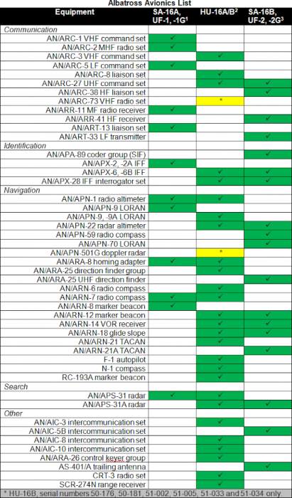

With all of the research into the Albatross I have been doing recently, it seems like the subject of electronic equipment keeps coming up. As if it wasn't already the most confusing aircraft in the world to research given all of its permutations (and resultant designations), the amount of systems that were packed into the airplane only makes it worse. So, to go on a little bit of a tangent, I wanted to see how many wartime and immediate postwar avionics manuals I could find and if I could compile them into a list for useful reference. Below is the result:
Digitized
References
  • AN-08-10-186 - Handbook of Operating Instructions for *AN/APN-1 and *AN/APN-1A Aircraft Radio Altimeter Equipments[1]
  • AN 08-10-265 - Handbook of Operating Instructions for Radio Sets *AN/APN-1, *AN/APN-1A, *AN/APN-1B and AN/APN-1X (Aircraft Radio Altimeter Equipment)[2]
  • AN 08-30AIA1-2 - Handbook of Maintenance Instructions for Interphone Equipment AN/AIA-1A[3]
  • AN 08-30APN3-2 - Handbook of Operating Instructions for Radio Set AN/APN-3[4]
  • AN 08-30APN4-2 - Handbook of Operating Instructions for Radio Set *AN/APN-4[5]
  • AN 08-30APQ7-2 - Handbook of Operating Instructions for Radar Set *AN/APQ-7[6]
  • AN 08-30APQ13-2 - Handbook of Operating Instructions for Radio Set AN/APQ-13[7]
  • AN 08-30APQ15-2 - Handbook of Operating Instructions for Radio Set AN/APQ-15[8]
  • AN 08-30APQ2-3 - Handbook of Maintenance Instructions for Radar Receiving Equipment AN/APR-2[9]
  • AN 08-30APR4-2 - Handbook of Operating Instructions for Receiving Equipment AN/APR-4[10]
  • AN 08-30APR5-2 - Handbook of Operating Instructions for Radar Sets AN/APR-5 (XA-1), AN/APR-5AY, and AN/APR-5A[11]
  • AN 08-30APS10-2 - Handbook of Operating Instructions for Radio Set AN/APS-10[12]
  • AN 08-30APS13-2 - Handbook of Operating Instructions for Radio Set AN/APS-13[13][14]
  • AN 08-30ARN5-2 - Handbook of Operating Instructions for Radio Receiving Equipments AN/ARN-5 and AN/ARN-5A[15]
  • AN 16-30AIC2-2 - Handbook, Operating Instructions: Interphone Equipment AN/AIC-2 and AN/AIC-2A[16]
  • AN 16-30AIC3-2 - Handbook of Operating Instructions for Interphone Equipment AN/AIC-3[17]
  • AN-16-30APN4-3 - Handbook of Maintenance Instructions for *AN/APN-4[18]
  • AN 16-30ARN5-2 - Handbook, Operation and Service Instructions: Radio Receiving Equipments AN/ARN-5 and AN/ARN-5A[19]
  • AN 16-30ARN14-2 - Handbook, Operating Instructions: Radio Receiver AN/ARN-14[20]
  • AN 16-30ARN14-6 - Handbook, Operating Instructions: Radio Receiving Set AN/ARN-14 and Radio Receiving Set AN/ARN-14C[21]
  • NAVAER 08-5Q-95 - Handbook of Operating Instructions for Model AN/ARC-5 Aircraft Radio Equipment[22]
  • NAVWEPS 16-30ARN14-8 - Illustrated Parts Breakdown: Radio Receiving Set AN/ARN-14B and Radio Receiving Set AN/ARN-14C[23]
  • NAVWEPS 16-35R541-2 - Handbook, Field Maintenance Instructions: Radio Receiving Set AN/ARN-14, AN/ARN-14B, AN/ARN-14D[24]
  • T.O. 08-55-42 - Radio, Radar and Electronics Spare Parts List for AN/AIC-2[25]
A few notes:
  • The cutoff date for inclusion in this list is 1960.
  • Manuals may be repeated if they appear under a different designation.
  • Original printed designations are used, even where they have been struck out and a new handwritten one added.
  • It seems as though the Navy simply added "50" to the beginning of the existing subject title (aka the third part) when creating its own system.
  • A similar effort is posted on the Radio Nerds website. The manuals List of Technical Publications, Communications Equipment, T.O. 16-1-01, and Manual of Test Equipment for Airborne Electrical and Electronic Equipment, NAVAER 08-SS-78, are also useful.
  • The National Electronics Museum has a significant collection of manuals in their library and archive.
EDIT (25-04-28): Added 23 digitized entries and an additional useful manual to notes. Removed 1 duplicate manual.
