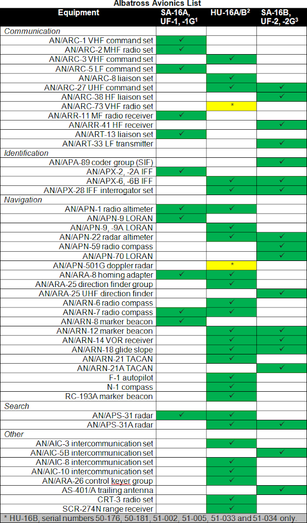

With all of the research into the Albatross I have been doing recently, it seems like the subject of electronic equipment keeps coming up. As if it wasn't already the most confusing aircraft in the world to research given all of its permutations (and resultant designations), the amount of systems that were packed into the airplane only makes it worse. So, to go on a little bit of a tangent, I wanted to see how many wartime and immediate postwar avionics manuals I could find and if I could compile them into a list for useful reference. Below is the result:
Digitized
References

A few notes:
  • The cutoff date for inclusion in this list is 1960.
  • Manuals may be repeated if they appear under a different designation.
  • Original printed designations are used, even where they have been struck out and a new handwritten one added.
  • It seems as though the Navy simply added "50" to the beginning of the existing subject title (aka the third part) when creating its own system.
  • A similar effort is posted on the Radio Nerds website. The manuals List of Technical Publications, Communications Equipment, T.O. 16-1-01, and Manual of Test Equipment for Airborne Electrical and Electronic Equipment, NAVAER 08-SS-78, are also useful.
  • The National Electronics Museum has a significant collection of manuals in their library and archive.
EDIT (25-04-28): Added 23 digitized entries and an additional useful manual to notes. Removed 1 duplicate manual.
File comment: 1 Steve Ginter, Grumman HU-16 Albatross, Naval Fighters 11 (Simi Valley, California: Steve Ginter, 1984), 3.
2 Technical Manual, Organizational Maintenance, General Aircraft: USAF Models HU-16A, HU-16B Aircraft, T.O. 1U-16(H)A-2-1, 28 March 1967, 9-1–9-4. Relevant pages noted as last changed on 1 October 1963.
3 Steve Ginter, Grumman HU-16 Albatross, Naval Fighters 11 (Simi Valley, California: Steve Ginter, 1984), 5.
