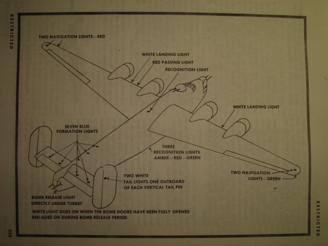

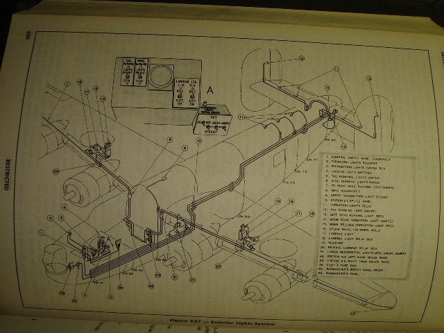

The mount you are trying to identify looks like the mount for the upward recognition light.
Most are familiar with the three downward recognition lights, red greed and amber, but there was an upward one as well. The upper light was a tear drop shaped clear light and matches the size and screw hole pattern in the photos on your web site.
The B-24J's upward recognition light was mounted on top of the fuselage over the wing.
I am trying to find a more detailed shot for you but all I have come across so far are these crude photos that I took from two different maintenance manuals. Look at number 9 in the first photo.
A similar mount is used on many different wartime aircraft. I believe that the standoff mount was used to give the upper light a better field of view.
I will keep looking for a photo of the actual mount. I would think that the Colling’s B-24J might still have the light and mount in place.
These lights are readily available today and you can even find them new in the box. I will gladly loan one to you if you need it to check the fit and hole pattern.
