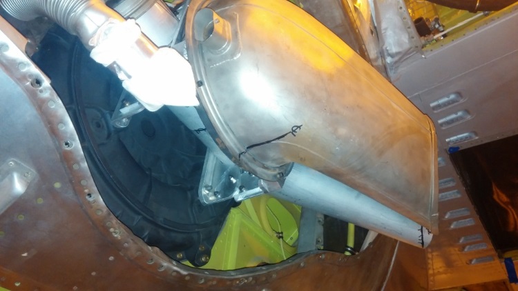

Quick update. We have just approved the use of straight pipes coming out of the exhaust vs using the hot section turbocharger housing. With everything in place and cowling installed everything will look exactly as original. Plus with this setup, upon engine start we may set off more than a few car alarms. It's still in work so the end product will look much better.

Just to ask, because I am curious about why this modification was done.
Will this negatively affect the engine or turbocharger by using straight pipes instead of the turbocharger housing?

They do not need the turbos as the plane will not fly at altitude, and but getting rid of the turbos hot section they will be eliminating a number of parts and weight. There will be no effect on the engine and there will be plenty of power as the engine still has it's supercharger.

As Matt said, the weight and maintenance are a big part, but also since they're using the same Hybrid engines as FiFi, the increased power of these engines makes them even more redundant as the engines will be operated at a lower power fraction than the old engines which gives more reserve power. Between that and the lighter overall weight (no bombs, not as much fuel, reduction in armor, etc), both Doc and FiFi are more than capable of cruising well into the flight levels (above 18,000 feet) even without their turbochargers if it should ever be needed.

Case in point, Rare Bear ran one of the engines designated for Fifi at the air races a couple years ago and did pretty well. After flying on Fifi earlier this year I was impressed by how quickly it got off the ground.
