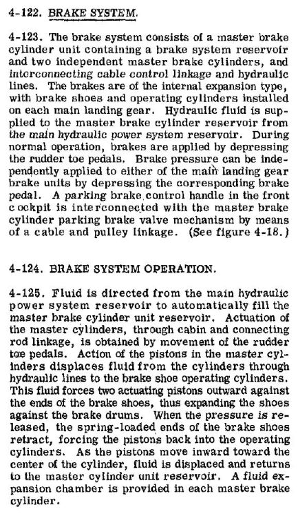

Learned something new...
Find Number 36-27
Part Number 168-58801-17 (? hard to read on my copy)
Line Assembly - Hydraulic brake supply firewall elbow to master brake cylinder
Find Number 36-29
Part Number 121-58026-11
Line Assembly - Hyd brake supply reservoir to firewall elbow
File comment: From T.O.No.1T-6G-2
