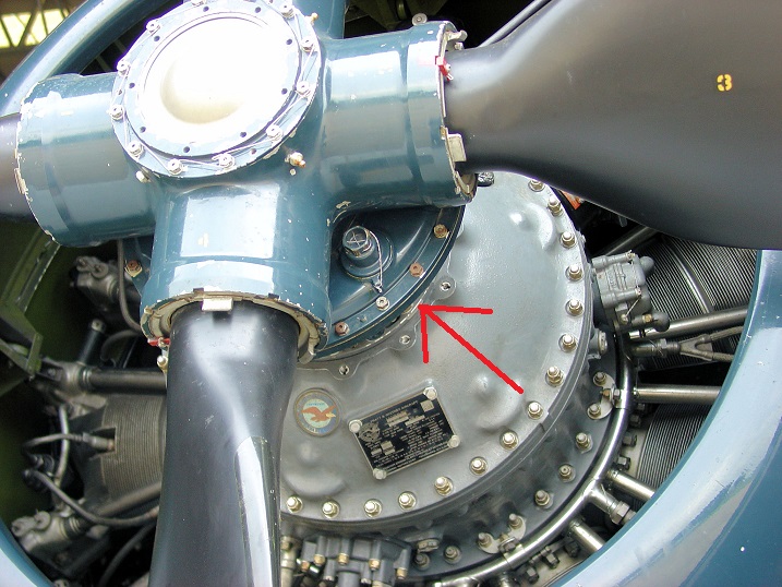

What is this unit between the hub and the crankcase nose? I would assume it is integral with the prop and has to do with pitch change?
Information and better picture (prop removed?) are much appreciated. As an alternative, let me know the type of prop and I'll do more research on my own.

Part of the Aero Products A642 prop according to the the IPB.

It is the prop governor. The nut looking plug with the safety wire attached to it is the filler plug. Turn the prop where that plug sits horizontally to check or add fluid
level. Uses regular 5606 hydraulic fluid. Best prop governor ever made, nary a problem with them if they are rebuilt correctly. That looks like the late Tom Woods kitty??

There is more info on the Aeroproducts prop and how it works here:
http://www.enginehistory.org/Propellers/Aeroproducts/aeroproducts.shtml
Scroll down to the second article.
