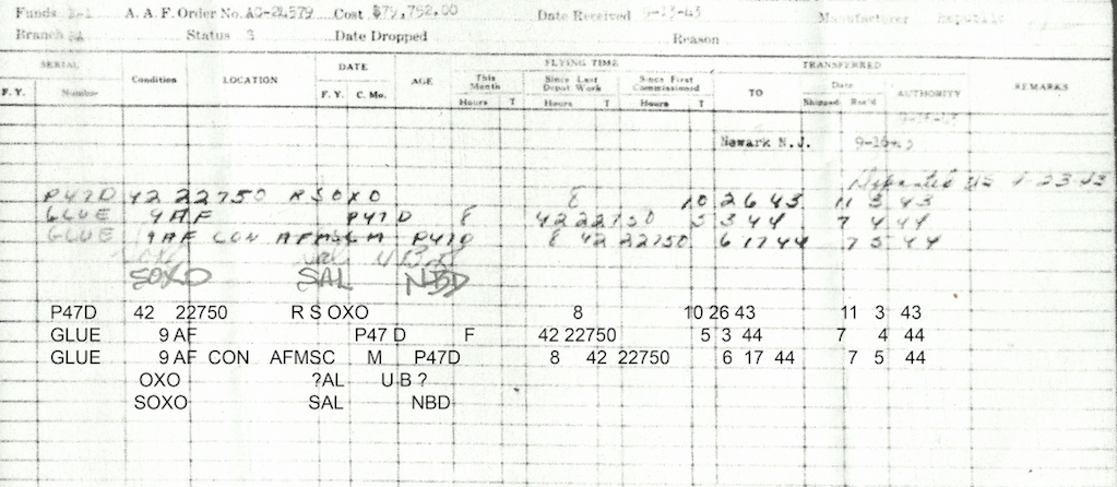

Well good to their word the helpful folk at AFHRA have ensured an early Christmas present arrived this morning. Its reasonably clear but (as expected) written in the USAF code. A screenshot is attached.
I have zoomed right in and taken a closer look to verify the text, and have appended the plain text below the handwritten lines.
Can anyone help with deciphering/translating the codes for us?
Best attempt at deciphering the record card. Date of loss of aircraft likely 17 Jun 1944 (or at least date deemed condemned) .

PostPosted: Sun Dec 30, 2018 9:13 am
Joined: Mon Sep 17, 2018 10:05 am
Posts: 20
jdeters79 wrote:
Thank you so much for this - much appreciated.
The conclusion? This record card and serial number is not related or linked in any way to the crash site we are investigating. Either way, its progress though.
