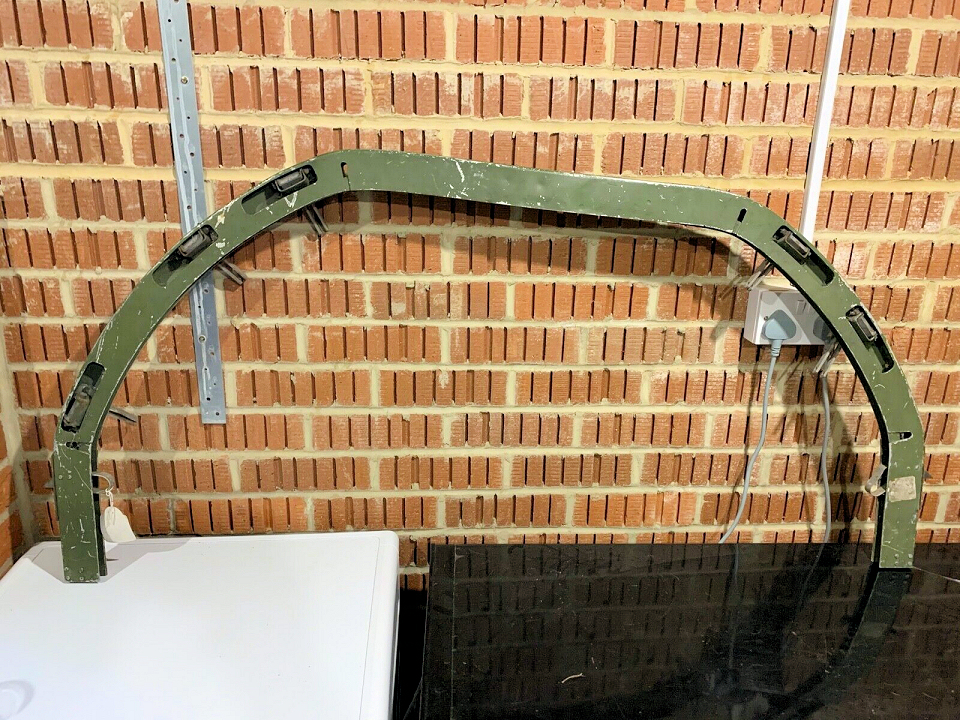

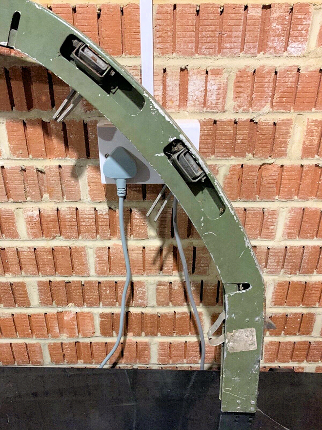

Evening all. In need of some of your collective expertise.... recently acquired this. It was advertised as a B-26 'Inner Bomb Bay Door'. That made sense given the layout of a B-26, but I'm concerned that the parts number(s) on the 'hinges' seem to stem from the range associated with the A-26. I've also been informed by a knowledgeable person that the stamped 'D' is for Douglas... which would also suggest A-26. Can anybody positively ID this part for me?

That’s a cowling support that goes on the Douglas A-26. Those brackets attach to the engine it has nothing to do with the bomb bay. That said, remember, the A-26 was redesignated B-26 after the Army-Air Force divorce in 1947. The Martin B-26 had been retired so nobody thought it would create any problems. Right!
Cheers chap. much appreciated. I found the 'hinge' part number in the A-26 parts manual I had and wasn't sure if it was a more generic part used in more than one aircraft. Excellent, I now have it ID'd! :-) Came from North France BTW...picked up by a local gentleman immediately after the war... not sure what he thought he'd do with it?! :-)
