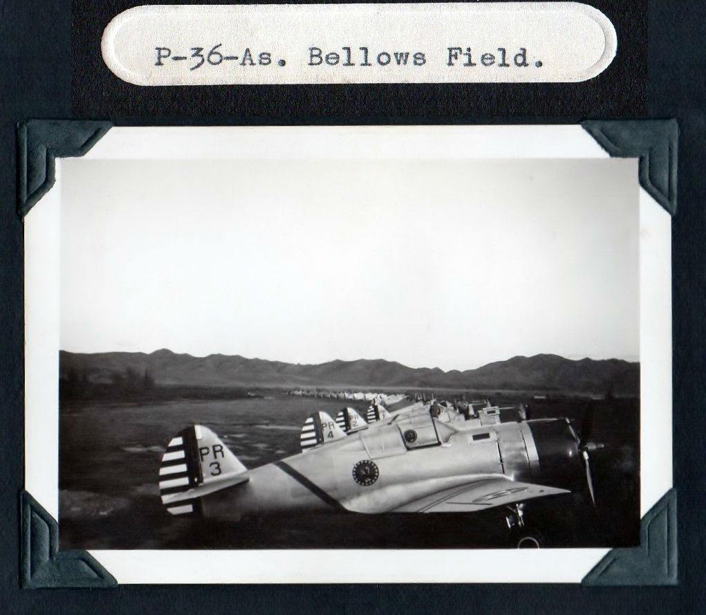

Just to mix it up. here is a rare prewar photo of P-36s at Bellows Field. I do not believe these are from the 46th PS.
