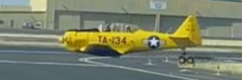

PostPosted: Tue Oct 13, 2020 1:40 am
Posts: 4742
ID?
PostPosted: Tue Oct 13, 2020 3:34 pm
Joined: Fri Jun 25, 2004 2:38 am
Posts: 87
Location: Netherlands
N821DS ?
PostPosted: Tue Oct 13, 2020 6:49 pm
Posts: 2943
BennoT6 wrote:
N821DS ?
Yes. Second of 2 T6 accidents reported that day. The one in Florida looks bad...
