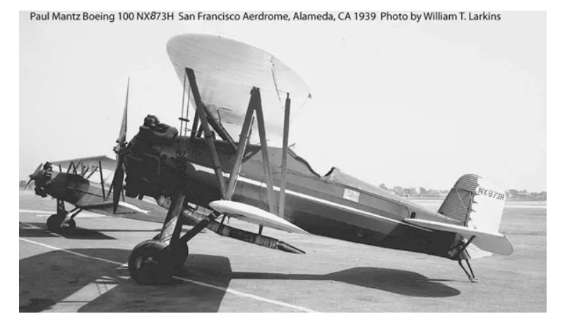

While the main gear certainly looks Stearman and the cowl and prop spinner look like a 450 P&W, allow me to point out the "N" cabane struts (which the Stearman lacks), the lack of a cutout in the top wing (like a P-12), the cockpit being located where a P-12's is...the Stearman's front cockpit is more forward, the back seat further back.
Finally, the fuselage is short coupled.
So if it is a Stearman, it has had extensive work done to the wings and fuselage.
It looks more like a P-12 than any 75 Stearman I've seen.
In fact, it looks more like a C2, but the curvature of the fuselage is closer to a P-12, (albeit rounder), in fact it looks like Paul Mantz's Boeing 100.
Photo from Scott's excellent Aerovintage site.
