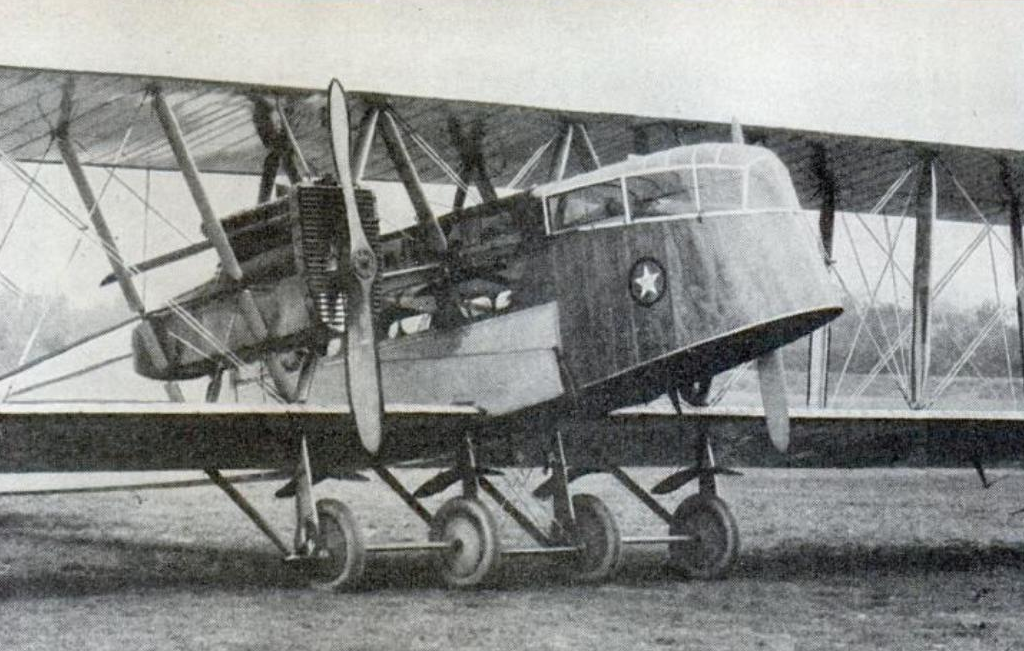

Finally, there are a few claimants for the first use of plastic on an aircraft, but the answer is muddied by the question of what constitutes "plastic". One possibility are the experiments done by the Germans during World War I with transparent cellulose acetate film on aircraft like the Fokker E.III:
(Source: University of Texas at Dallas)
and Linke-Hofmann R.I (which is oddly similar to the later Soviet An-2CX):
(Source: Wikimedia Commons)
The United States was not far behind, with Martin introducing it on their MB-2 in 1921:

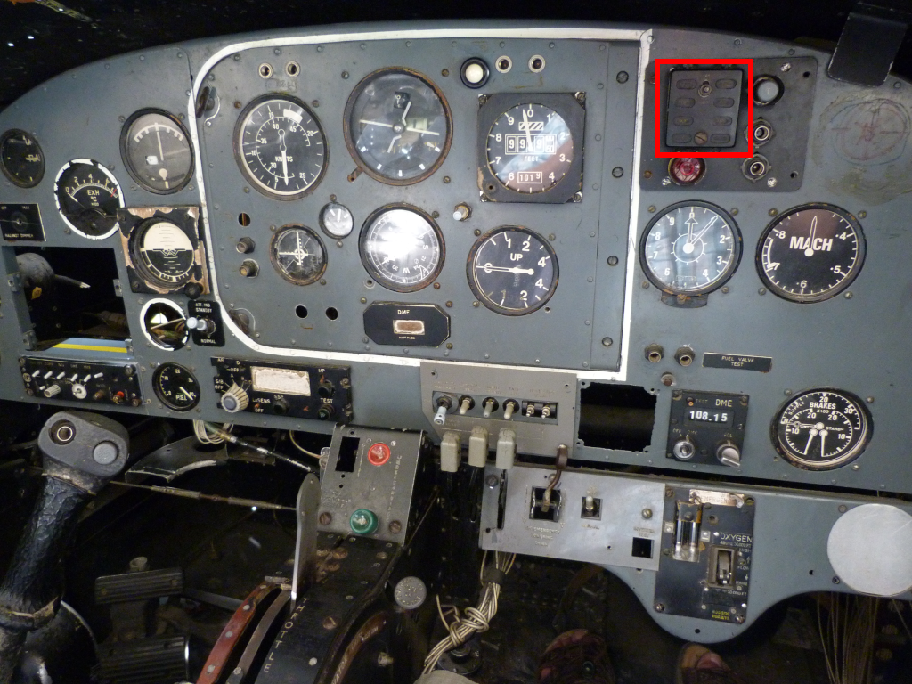

Determining the first aircraft with an annunciator panel is difficult - partially because the term refers to servant bells and burglar alarms that go back to at least the 1800s![1] However, a good candidate for the first aircraft example is the "centralized warning panel" in the Hunting Percival Jet Provost.[2] I believe the CWP is the device outlined in red in the picture of the cockpit of Jet Provost T.3, XM373, below:
For comparison, a picture of the restored instrument panel of a Jet Provost T.4, XP558, is available in a BritModeller thread.
