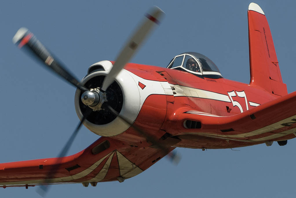

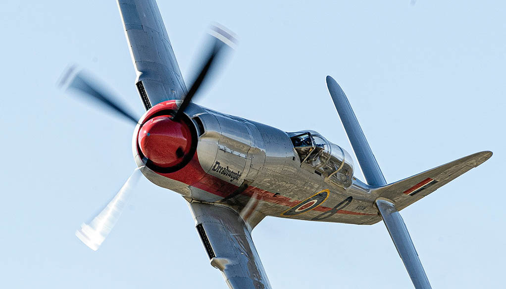

Oh, so I guess we're not talking race power here. That's where it gets interesting...
