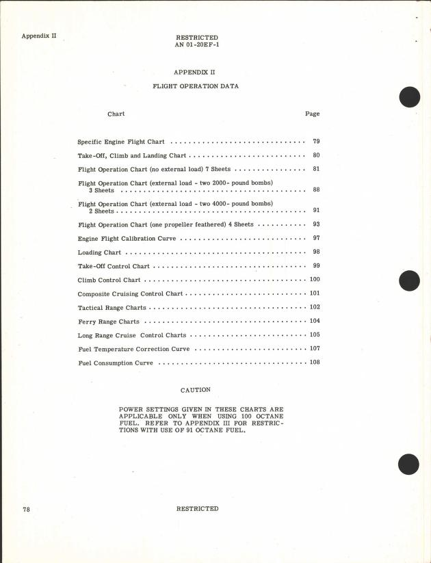

    • One aspect that traditional aircraft signs do a poor job of conveying is the variability of aircraft performance. Guests often ask things like: "What is the top speed of this airplane?" or "How high can it fly?" and expect a single answer. However, anyone who has ever looked in the back of a pilot's manual and seen the pages and pages of tables and charts (see table of contents attached) knows that there is not one single answer to this question. Aircraft performance depends on air temperature, altitude, fuel load, payload, and a bunch of other factors. Our Merlin engine label (which I, unfortunately, cannot take credit for) did a good job of this. It listed the horsepower of the engine as "1565 at 3000 RPM and 12,250 ft" instead of just "1565 hp". However, this adds an additional level of complexity that might overwhelm the average visitor.

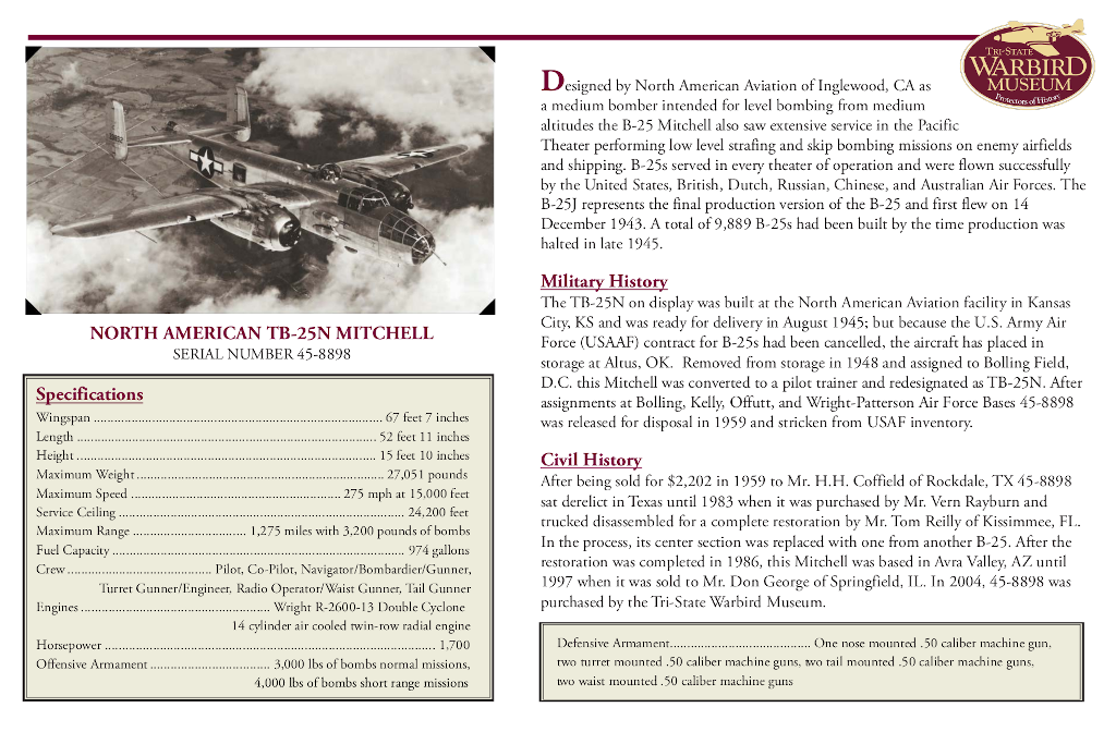

The pedestal signs (i.e. the signs for each plane) at our museum have a historic picture of the aircraft, a list of specifications and a short narrative summary. The narrative summary is broken down into three parts: a general history of the aircraft type, the military history of the airframe in the museum and the civilian history of the airframe in the museum. (see attached for an example)
Regarding more specific implementations for exhibits, one interesting case I dealt with a while ago was a display case we have showing the World War II U.S. Navy training sequence. It included models of a J3C, N2S, SNV, SNJ and F4U and each aircraft had an associated 8" x 6" label that gave a brief overview of the aircraft and some specifications. When I remade the labels, I decided to limit the facts listed and settle on a consistent format. However, the key decision was that I wanted the specifications to emphasize the overall message of the case. Given that I interpreted the message to be the increasing difficulty and complexity of the airplane at each stage in training, I picked gross weight, top speed and horsepower. Previously, the list of facts included details such as manufacturer, cost and number built. (see attached for pictures comparing the old and new labels and an overall view of the display case) Now, admittedly, this isn't your standard pedestal sign next to an airplane situation, so it didn't have to follow the rules above. However, I still feel that there is a relevant takeaway here in that when writing labels for an exhibit, it is worth considering the larger context in which they will be displayed and how it reinforces or hinders any message you want to convey.
Attachment wrote:
Depicting Aircraft Specifications in Public Displays
By Noah Stegman Rechtin
3 August 2017
Should the specifications reflect the particular accompanying airframe or an idealized version of it?
Which variant should the specifications reflect?
The specifications on a display, by necessity, are discrete. It would be too complex for the average visitor to list every possibility. However, to a pilot, an aircraft’s specifications fall somewhere within a range determined by a large number of factors. This is why a chart depicting the flight envelope is not just a line, but an area.
The Pearl Harbor Aviation Museum’s Pearl Harbor Blog has an excellent post about the similar difficulties in finding the correct top speed for the Mitsubishi A6M “Zero”. It also notes the fact that many of the specifications given in popular books do not list sources.[1]
There are two situations that can cause a range of numbers to have to be selected from. One occurs when the historical record is either contradictory or lacking. For example, when two different top speeds are reported in two different sources. The other happens if there is no definitive answer and it has to be qualified. For example, when one top speed is possible under certain circumstances and a different one is possible under another.
B-25 Example
  • B-25 (Wartime Model)[2]
    • Length: 54 feet
    • Wingspan: 67 feet, 6 inches
    • Height: 15 feet, 9 inches
    • Empty weight: 20,300 pounds
    • Maximum capacity load: 35,000 pounds
  • B-25C[3]
    • Length: 54 feet, 1 inch
    • [Wing]span: 67 feet, 6 inches
  • B-25J[4]
    • Length: 53.5 feet
    • [Wing]span: 67.6 feet
    • Height: 16.3 feet
    • Empty weight: 19,530 pounds
    • Combat weight: 27,400 pounds
    • Take-off weight: 35,000 pounds
  • B-25J (2)[5]
    • Length: 53 feet, 5 3/4 inches
    • Wingspan: 67 feet, 7 inches
    • Height (to top of fin): 16 feet, 4 3/16 inches
    • Design gross weight: 26,150 pounds
    • Maximum allowable gross weight: 36,500 pounds
  • B-25J (3)[6]
    • Over-all Length: 53 feet, 5 3/4 inches
    • Over-all [Wing]span: 67 feet, 6.7 inches[7]
    • Over-all Height (3-point Position): 16 feet, 4 3/16 inches
    • Weight (Highest Known): 36,600 pounds
  • TB-25L[8]
    • Length: 53 feet, 6 inches
    • Height (to top of fin): 16 feet, 4 inches
    • Normal gross weight: 26,000 pounds
  • TB-25M[9]
  • TB-25N[10]
Endnotes
  1. How Fast Was the Zero?,” Pearl Harbor Aviation Museum, April 9, 2012.
  2. Pilot Training Manual for the B-25 Mitchell Bomber (Headquarters, AAF, Office of Flying Safety, n.d.), 18.
  3. Recognition Pictorial Manual, FM 30-30 (Washington, D.C.: Training Division, Bureau of Aeronautics, Navy Department, 1943), n.p.
  4. Characteristics Summary,” May 17, 1950.
  5. AN 01-60GE-1, pages 1 & 85, April 1944, 28 June 1946 & 24 April 1947.
  6. T.O. 01-1-131, 24 March 1945, page 2.
  7. Oddly, this particular dimension is given in decimal format when all other measurements for the B-25 that are less than whole are fractions.
  8. T.O. 1B-25(T)L-1, page 1-2.
  9. T.O. 1B-25(T)M-1, pages 1-1 and 1-2.
  10. T.O. 1B-25(T)N-1, pages 2-3.

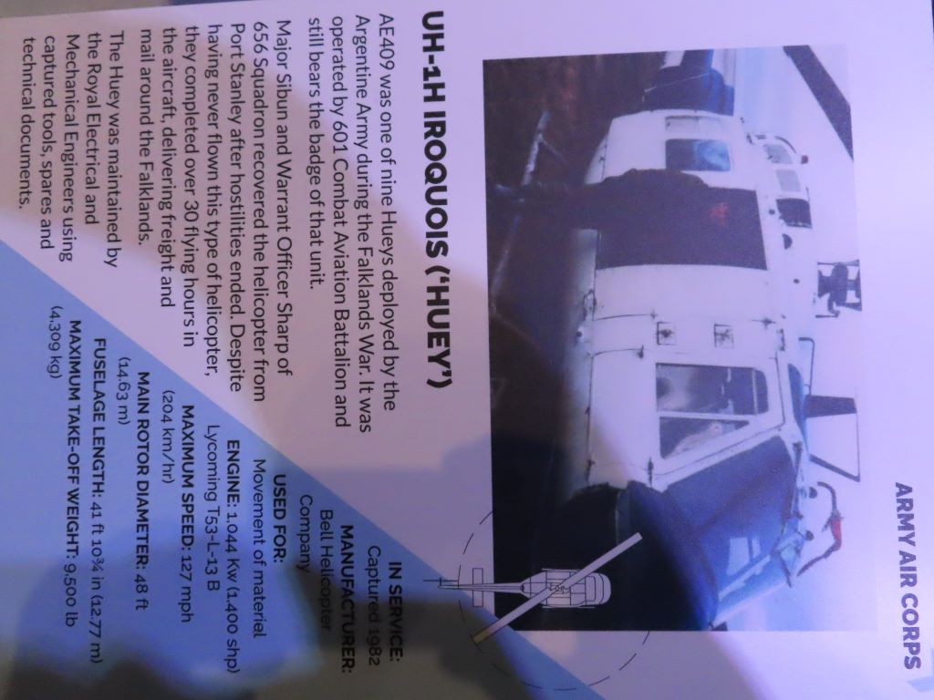

The Army Flying Museum, Middle Wallop in the UK had a revamp of its displays in 2018, part of which was a standardisation of the exhibit labels. All exhibits had labels of the same size and style which meant that space for descriptions was limited to 80 words. The result was descriptions that had to 'give' something interesting to youngsters, enthusiasts and non enthusiasts equally, somewhat of a challenge, but a fun one all the same.
This is the panel for the ex Argentine Huey and as you can see the 80 words were used for the aircraft's individual story. The word limit didn't leave any room for an explanation why the aircraft is brush painted in white household emulsion, that part of the story is usually left to the museum's explainers.
