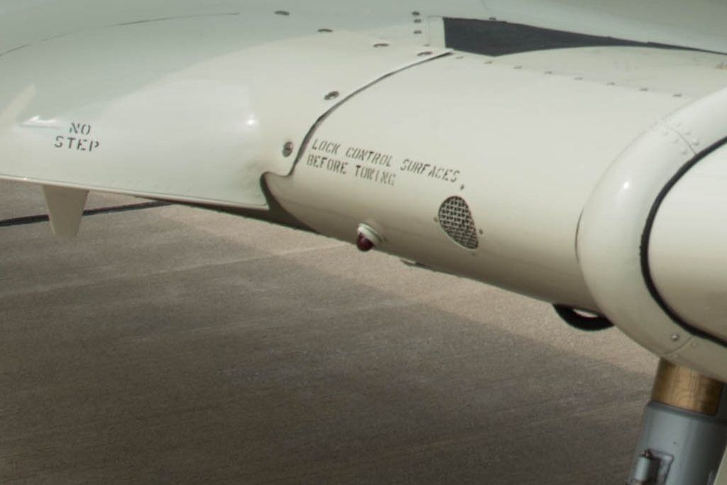

I just so happened to find a good picture of 42-84757 showing one of the lights today:
(Source: Warbird Training Center)
Warbird Philosophy Webmaster

Here's mine! One on each side.
PostPosted: Mon Jun 19, 2023 10:13 pm
