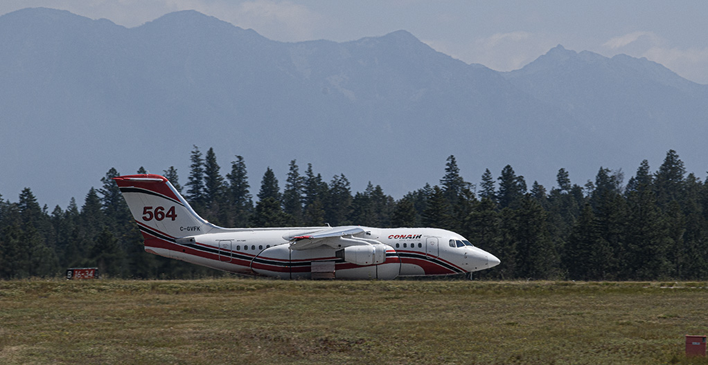

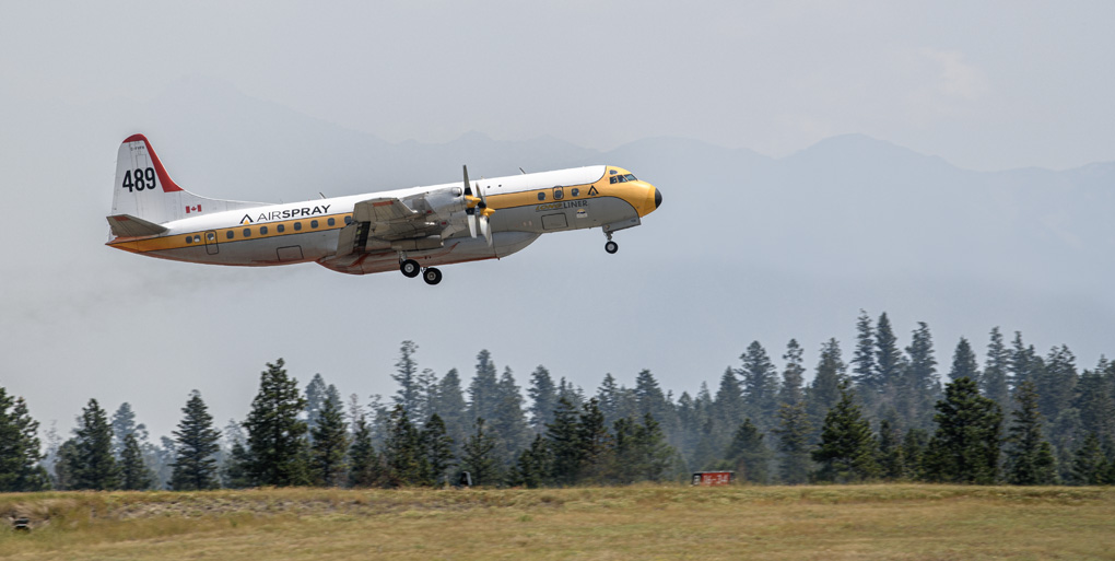

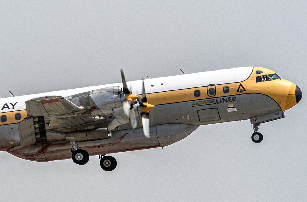

Down in the US we saw Neptunes and Orions. Up here we have converted Electra airliners. This one dates from 1980, and was owned and operated by the Los Angeles Dodgers for several years.
We have been pretty much fire free to this point, but that is changing fast. The big firebombers have been elsewhere in the provice (150 or more fires burning at once with some really big). This weekend we had a smallish lightning fire about ten miles from our house and less than 5 miles from the airport. On Sunday it became a big nasty fire due to extremely windy conditions. By Monday it was a couple thousand acres and had taken at least three homes. The fire service hit the fire really hard and things are stable (if scary) now.
The airport and firebase were right at the edge of the smoke cloud -- you can see the smoke in the trees and obscuring the Rockies in these shots, and how much clearer it was looking away from the smoke. It took a lot longer to load the airplanes than it took for the airplanes to get rid of their loads.
Click on the pictures for a better look...

Thank you Andy and we plan to do so. It stinks outside, but as far as we know the fire is not moving much. It is still just 6 miles away, so the town is on edge. No evacuation alerts here yet, which is a good thing. I just hope the winds stay quiet.
I preferred the old days, when I had to travel to photograph firebombers...

I suspect that the Mars is out of the game now for the same reasons that all the other old, WW2-era iron is. Too bad. I'd be very curious to know what the cost of a gallon of water delivered via the Mars is vs a -215 or a -415. I bet the Mars was cheaper.
The Electra is a phenomenal tanker. I'm currently on my sixth season flying an Electra tanker and it's a marvellous platform with it's 3000 us gallon tank and four Allisons. The Electra is one of the few airplanes out there that will descend and slow down simultaneously, which makes it easy to paddle around the circuit five or six hundred feet above your drop altitude so you can see better, and at a comfortable one-hundred and fifty knots or so. Our target drop speed is one-hundred and twenty-five knots and on final a mile or so back from the trigger point she'll shed both her excess speed and altitude without really working very hard to do it. As soon as the load is gone and you open the taps she's accelerating instantly and easily and climbing away. The Allisons give you INSTANT power as they are always running at 100% rpm so there is no spool-up. And you've got three-thousand pounds of power steering so you can literally fly her around with your fingertips. She must have seemed like an absolute spaceship when she showed up in the late fifties/early sixties. I'd love to get my hands on a P-3 someday and take it for a spin as you don't have to fly an Electra very long to realize why somebody figured out it would be a good sub-hunting platform - she's a natural attack airplane!
And for you nostalgics out there, the tanks on our two Electras are the old Aero Union, eight-door, DC-4 tanks, fillable to a higher level. Unlike a constant flow tank these ones you can drop in single doors, double doors, half loads, or the whole smash all at once (which is kinda uncomfortable) and in high or low flow.
