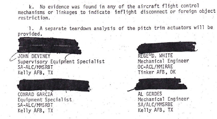

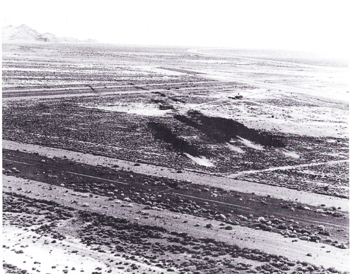

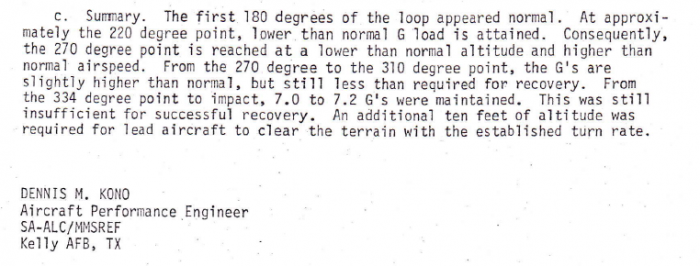

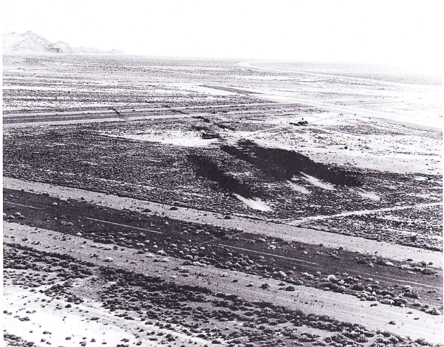

You're right, that's what the one publicly-released Report said. But there's a lot more to the story, some of it contained in the not-publicly-releasable Safety Board report. A bootleg copy of the Safety Report was posted to the internet several years ago, and contains some interesting stuff.
FWIW, it isn't that they didn't pull out...they almost made it...the Safety report concludes Thunderbird 1 needed 10 more feet to not impact the ground (that probably means 30 feet for the entire formation to make it, based on "the stack" when T-38s are in fingertip).
The Safety Report doesn't definiteively state what occurred: there were no electrical or mechanical deficiencies in Thunderbird 1's aircraft found by any of the various investigators on the Safety Board. That being said, the TAC Commander General Wilbur Creech, was widely known to have meddled in the report prior to its publication, famously saying to witnesses that "Thunderbirds don't make errors".
Side Note: Creech personally erased the video shot from the ground of the accident and the maneuver leading up to it -- completely in defiance of several regulations that require preservation of such accident evidence -- so it could not ever be released.
Creech demanded that the Investigation Board go back and find another cause. Thus, the Safety Report speculates blame on "a malfunctioning pitch trim system", even though there is no word about this malfunction in any of the component investigations contained in the report.

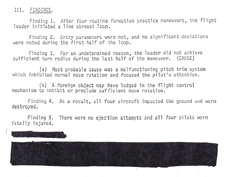

Below are the revised findings from the USAF-internal-only Safety Report.
Note that there's no mention of a "jammed stabilizer", which is indeed what was released to the general public in the Accident Investigation Report (a different board and a different report than the Safety Investigation Board, which is what I'm quoting here) and published in both Aviation Week and the NY Times.
Note this summary from one of the sub-inspections inside the Safety Report...which contradicts what I just posted above from the overall summary of the investigation. Creech was able to make the Investigation board change the summary, but not the sub-component inspection reports because those guys at Kelly AFB didn't work for Tactical Air Command or General Creech.
Ed Rasimus, who many WIXers will recognize as a well-known author, fighter pilot, Vietnam combat vet, was an AT-38 Instructor Pilot at the time of the accident. He wrote this on the old USEnet rec.aviation.military news group about the accident.
The accident report was very controversial. As the only TAC unit other than the 'Birds flying the T-38, the 479th TFW at Holloman was tasked to supply both the Flying Safety Officer member and Pilot member to the accident investigation board. Both pilots were out of my unit, the 435th TFTS.
The initial report of the board was a finding of pilot error. The lead aircraft had topped out on the loop at an altitude below the minimum required to insure a safe recovery. Failure to recognize the altitude
and continuation of the maneuver to the pull through meant that after reaching about 60 degrees nose low inverted, the formation was in a position from which recovery was no longer possible.
There was evidence reported that the control stick and linkages were deformed probably due to pilot effort to pull through at whatever G was available.
When the report was submitted, General Creech returned it and reconvened the board with the statement that "Thunderbirds do not commit pilot errors." Command guidance was to come up with another cause.
That was when the "shock absorber" was invented as the culprit. What made the report a laughingstock for T-38 pilots (although acceptable to Gen. Creech and the general public) was the fact that with 160 AT-38B aircraft on the ramp at Holloman, with at least 1000 maintainers and more than 200 Talon IPs on the base and with more than 20 years experience operating the airplane for the USAF, no one had ever before heard of the "shock absorber" and no one could find any reference to such a gadget in the control system schematics.
Source post: https://www.yarchive.net/mil/thunderbird_crash.html
The Safety Report itself is an interesting read, I'll email it to anyone who is interested. I don't have a copy of the Accident Board Report, but that was published by Aviation Week in 1982 if anyone wants to dig through their archives and count up the differences between the Safety Report (the one not releasable to the public) and the Accident Report.

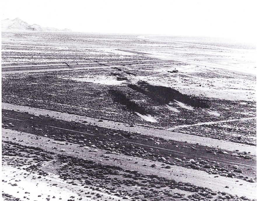

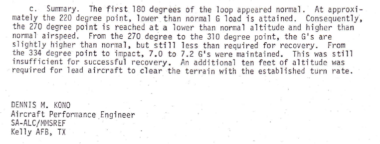

I've always found that controversy interesting because of the statement by Ed Rasimus about the "shock absorber". Aviation week had a pretty good explanation and pictures of the overload cylinders of all four aircraft with the condition of the leads cylinder being the reason for the locked up stab theory. I wouldn't mind having a copy of the report.

wonder how many regs Creech overlooked and broke to change and bury the actual cause. I did read where he had all copies of the video destroyed.
But it does show that the wingmen did not take their eyes off the lead plane. No matter what others say, and say that fast does not say that you must watch your leader at all times, this is proof that they never looked anywhere other than at their lead plane.
