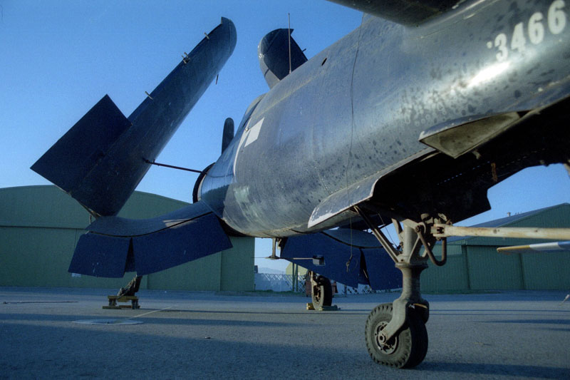

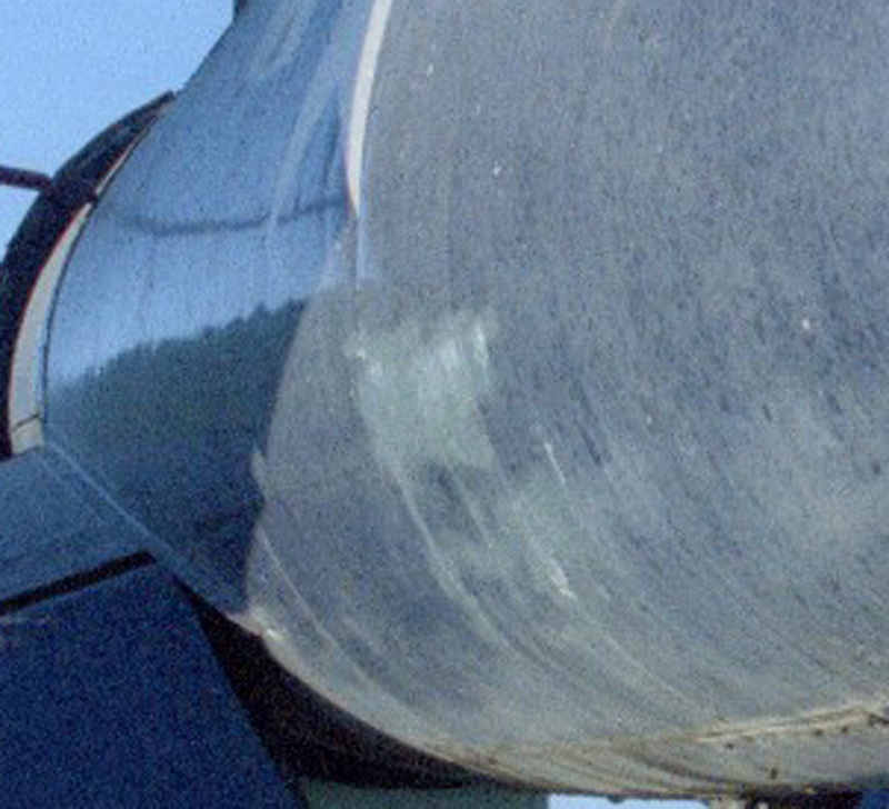

I took several pics of 92132 at Chino in the early 1990s including one closeup of the lower left rear fuselage.
The area in question is flush with the rest of the skin around it in my photos, but there is a discolored patch about the shape and location of the recessed area, indicating it may have been modded by then.
The work that was done to this area is something I've never been able to fully figure out. I did a short bit of research trying to piece the history together:
Noha307 wrote:
Unanswered Questions
On the rear fuselage of 92132 exist two sets of what have sometimes been referred to as "patches". In actuality, these "patches" are holes that have were drilled into the skin and were later filled with oversized rivets. The area around the holes was then sanded flush – removing the surface layer of anodizing on the aluminum and giving the appearance of a "patch" from a distance.
For many years, it was suggested that the holes (six on the left, four on the right) on either side of the rear fuselage were mounting points for smoke generators used in the filming of Baa Baa Black Sheep. These device(s) were used to replicate damage to the aircraft when the script called for a Corsair to be "shot down".
However, this claim did not stand up to scrutiny. Specifically, the smoke generator in the show was mounted under the right wing root, not attached to the rear fuselage.[1]
In its place, a second claim arose: the holes were the remnants of mounting points for rocket assisted take-off (RATO) bottles.[2] However, analysis of a wartime training film depicting a Corsair with RATO bottles shows that the bottles were mounted farther forward than the location of the holes on 92132. Additionally, the film shows that the unit is attached with three mounting lugs that form a triangular shape. A shape with these dimensions is not possible with the layout of the patches on the right side of the rear fuselage.[3]
An 8AS-1000 RATO bottle (NASM)
While it is still unclear, the truth appears to be that the first explanation was close to the truth, but not exactly correct. In one of the episodes, Pappy Boyington is shot down by his fictional friendly rival Tomio Harachi. When Harachi fires on Boyington's Corsair, a pyrotechnic explosion is seen to emanate from the left rear fuselage of the airplane. While the camera angle is such that the device that produced the explosion is hidden from view, the this is roughly where the holes are located.[4]
Endnotes

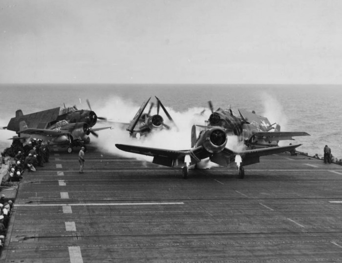

USS Altamaha Tests
One series of photographs documents a test aboard the USS Altamaha (CVE-18) on 1 March 1944.
It begins with NARA photograph 80-G-215654, which shows a Corsair in the middle of the deck shortly after igniting its JATO bottles, but with the tail wheel still on the deck. Behind it are an assortment of aircraft – two Wildcats, two Avengers, a Hellcat and another Corsair. This is further evidence that event represented is a test as such an unusual group would never have been operated together on a single ship.[1]

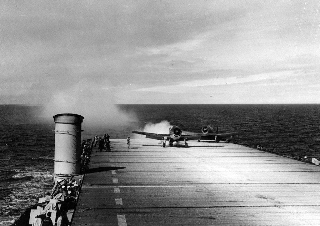

The second photograph shows the Corsair farther into its takeoff run – with its tail wheel in the air. As the aircraft has moved closer to camera, three letters on the engine cowling and rudder are now legible: ATO. It is evident that all of the aircraft in the shot have been marked in the same way. This acronym likely stood for “assisted take off” and presumably indicated that the aircraft had been modified with special equipment to mount the JATO bottles. Also visible is the Corsair’s side number, C91.[2]
A third photograph shows the aftermath. All but the Hellcat and a previously obscured Dauntless have taken off and the deck of the carrier is covered in a white residue expelled by the JATO bottles.[3]
Further details regarding these tests comes from an individual by the name of Rich Leonard. In multiple forum postings he describes how his father, LCDR William N. Leonard, was the pilot of Corsair C91, BuNo 56048, during the test.[4] He provided two additional photographs of the test.[5]
The first shows C91 from the right side prior to launch with a JATO bottle mounted directly beneath the cockpit and only a few inches behind the trailing edge of the wing flap.
The second shows C91 after it has passed the mid-point of the flight deck, with smoke streaming from the JATO bottle.
Rich, citing William, states that “[t]he concept was investigated a means to increase the number of planes on escort carriers thru shortening the deck space needed for launch by increasing take off speed”, but that it was not used operationally as:
Rich Leonard wrote:
[T]he exhaust from the JATO units covered everything with an ugly white glop that was hard to remove, especially from the windscreens and canopies of the aircraft parked on the stern. There was some suspicion that this glop might also have some corrosive effect on aircraft and equipment if not removed immediately.[6]
In any event, the spray would have certainly reduced the tempo of aircraft operations as the windshield of each aircraft would had to have been cleaned following the launch of the one ahead of it.
