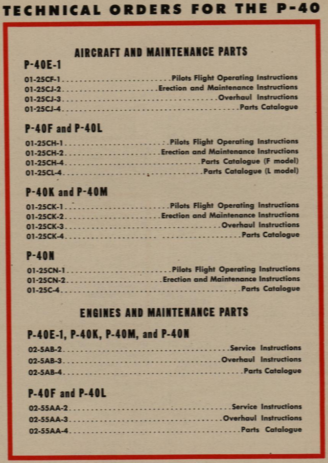

The Pilot Training Manual for the P-40 has a chart listing the applicable technical orders for various variants that is particularly useful for understanding the format:
(Source: Pilot Training Manual for the P-40 (Headquarters, AAF, Office of Flying Safety, n.d.), 91.)

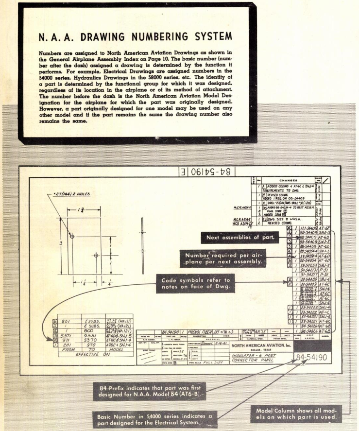

Slightly off topic, but still similar enough to be relevant are the company designations used by manufacturers as prefixes for part numbers. As mentioned in another thread, an extensive list was available from the Aviation Archaeological Investigation and Research website.
The parts catalog for the T-6 explains how this also applies to drawing numbers:
(Source: Parts Catalog: USAF Series T-6D (AT-6D), T-6F (AT-6F); Navy Models SNJ-5, SNJ-6 Aircraft, AN 01-60FF-4, 13 July 1948, 4.)

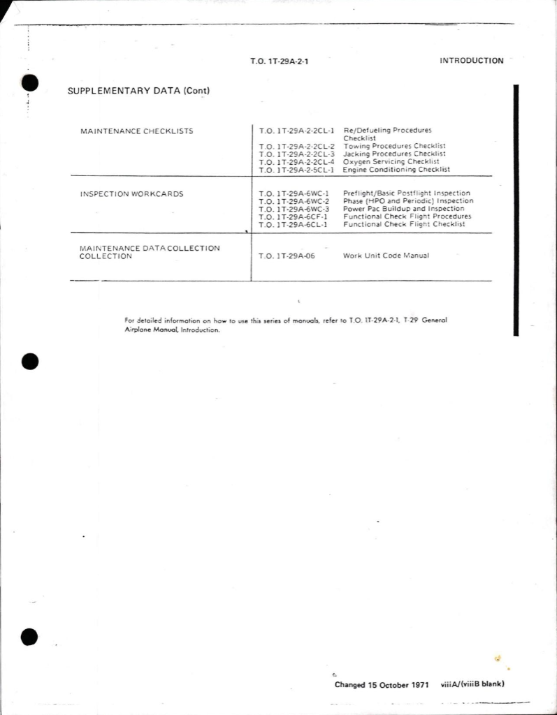

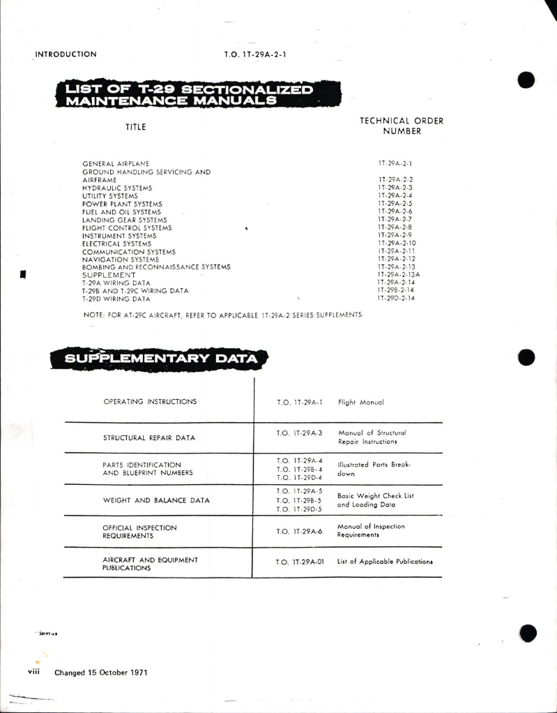

Due to the increasing complexity of aircraft, at some point postwar it no longer was practicable to have all of the different systems in a single manual. Therefore, the Air Force began subdividing maintenance manuals, that is to say -2s, into separate volumes. These "sectionalized handbooks" were identified with an additional dash number following on the end of the T.O. number. (e.g. -2-1, -2-2, -2-3, etc.) The 1 October 1973 edition of T.O. 1T-29A-2-1 has a helpful introduction to the system:
(Source: AirCorps Library)
For comparison, the 28 March 1967 edition of T.O. 1U-16(H)A-2-1 lists the following on the title page:
  • T.O. 1U-16(H)A-2-1 - General Aircraft
  • T.O. 1U-16(H)A-2-2 - Ground Handling, Servicing and Airframe Maintenance
  • T.O. 1U-16(H)A-2-3 - Pneudraulics
  • T.O. 1U-16(H)A-2-4 - Power Plant
  • T.O. 1U-16(H)A-2-5 - Fuel Systems
  • T.O. 1U-16(H)A-2-6 - Landing Gear
  • T.O. 1U-16(H)A-2-7 - Flight Controls
  • T.O. 1U-16(H)A-2-8 - Instruments
  • T.O. 1U-16(H)A-2-9 - Electrical System
  • T.O. 1U-16(H)A-2-10 - Radio, Communications, and Navigation Systems
  • T.O. 1U-16(H)A-2-11 - Wiring Data
(Source: Organizational Maintenance, General Aircraft: USAF Models HU-16A, HU-16B Aircraft, T.O. 1U-16(H)A-2-1, 1967, i-ii.)
By comparing the two above, it seems that the first two books are always the same. Following that, the order appears to remain the same even if some of the sections are not present. Furthermore, the first editions of these manuals date to 1957 and 1959, respectively - potentially indicating when the system was initially implemented.
EDIT (25-04-24): Added 1 additional chapter to the HU-16 maintenance manual. I had missed it because it was on the back side of the table of contents.

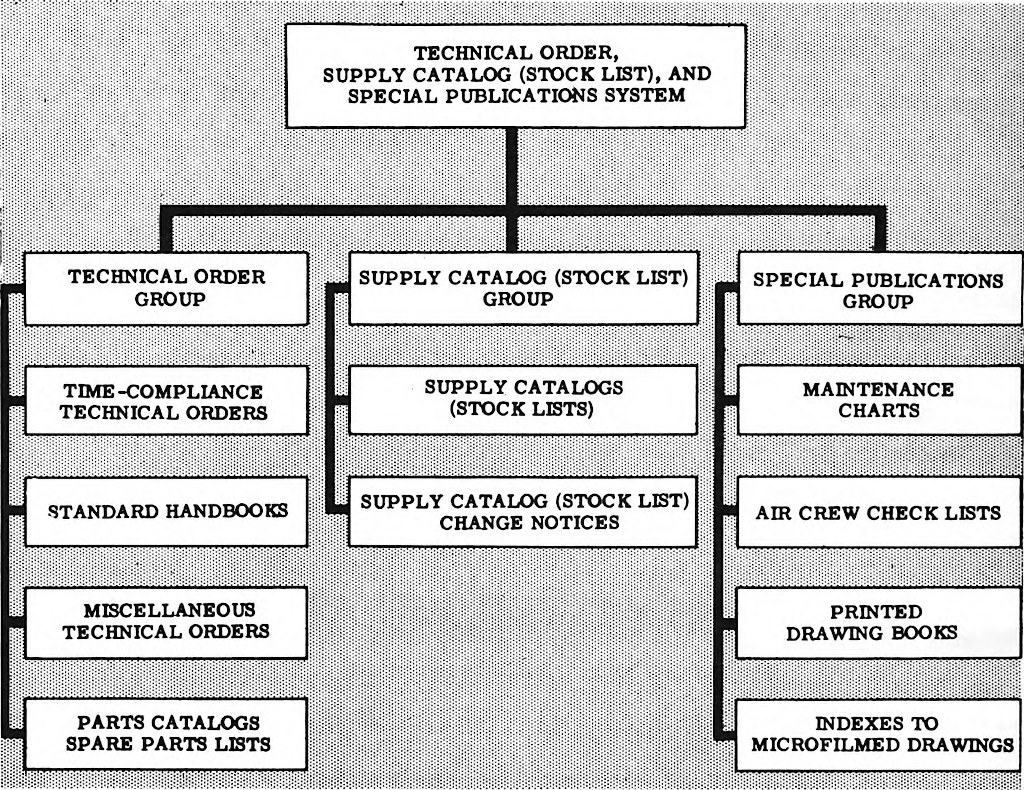

A detailed explanation of the purpose, format and types of each type of technical order can be found in a textbook intended for Reserve Officers' Training Corps students from 1949:
Air Force Armament, Volume I wrote:
5. AIR FORCE TECHNICAL
 PUBLICATIONS

have resulted in the adoption of the standard
system outlined below (See Figure 2-6).
File comment: Major Groups and Types of Publications
Major Groups and Types of Publications (Cropped, Reduced, Converted).png [ 564.21 KiB | Viewed 18421 times ]
Major Groups
 Three major groups, comprising appropri-
ate types of publications, form the standard
Air Force technical publications system. (See
Figure 2-6):
Technical Orders (including applicable Air
Force-Navy [AN] publications).
 Supply catalog (stock list) publications.
 Special publications.

File comment: Miscellaneous Technical Orders
Miscellaneous Technical Orders (Cropped, Reduced, Converted).png [ 470.39 KiB | Viewed 18421 times ]
Format. Parts catalogs and spare parts
lists are published with title pages and "A"
pages similar in design to those employed for
standard handbooks, except that the words
"Parts Catalog" or "Spare Part List" precede
the names of the equipment covered by these
publications. Data contained in these publica-
tions are arranged in tabular form.
Supply Catalogs (Stock Lists)
 The purpose, contents, and use of Air Force
supply catalog will be discussed in the section
titled "Armament Supply."

craft accessories manufactured by a specific
contractor. Procurement and distribution of
new printed drawing books and revisions
thereto is no longer being made.
AF Maintenance Charts. Maintenance in-
struction charts and engine limits and lubri-
cation charts are charts 22 x 34 inches and
20 x 30 inches respectively, for use by main-
tenance personnel in the maintenance of AF
equipment and for instructional purposes.
They are available upon requisition only. Pro-
curement of new engine limits and lubrication
charts is no longer being made.
Changes to Publications
Methods Employed. Changes to existing
Technical Orders and special publications are
made either by means of revisions, reissues,
supplements, appendixes or addenda. Use of
loose-leaf format permits efficient, econom-
ical, and speedy revision of many types of
technical publications within the system. Re-
moval of publications from active status is
accomplished by rescission or replacement.

At some point after World War II, two letters (frequently followed by a double zero) were added to certain technical order numbers to indicate their purpose. They include:
  • CF - Check Flight
  • CL - Check List
  • FI - Fault Isolation
  • FR - Fault Reporting
  • GE - General Equipment
  • GS - General System
  • GV - General Vehicle
  • JG - Job Guide
  • TS - Troubleshooting
  • WC - Work Card
  • WD - Wiring Data
Ester also states in her blog post how certain dash numbers were tied to certain manuals. (e.g. "-4" manuals were always parts catalogs) It appears that more of these connections were developed postwar:
  • -6CF-1 - Functional Check Flight Procedures
  • -33-1-1 - Nonnuclear Munitions Loading Procedures
Lastly, a C-141 Handbook has a list of applicable technical orders starting on page xi that is particularly useful as an illustration of how modern examples are organized.

  • T.O. No. 01-60JC-4
  • AN 03-10BA-88
During WWII, document numbers had the relatively standardized format of including three
distinct sections, each separated by a dash(-).
   Overall Identifiers:
   These identifiers come before the document number itself, and can be an indicator of the
   time frame when a document was published.
    • T.O. No.” stands for “Technical Order Number” and was the designation used on
      documents prior to WWII and through part of 1943.
    • AN” stands for “Army-Navy Number” and was the designation given to
      documents between approximately 1943 and 1953. In 1953 the Navy continued
      to use a variation of AN numbers, while the Army/Air Force transitioned back to
      identifying their documents with “T.O. numbers”.
   Section Numbers:
   Series numbers, or section numbers as they were later called, are the first set of digits in
   a document number. These numbers tell the user the very broad overall topic of the
   document.
    • The “01-” in T.O. No. 01-60JC-4 indicates that this manual is about an aircraft.
    • The “03-” in AN 03-10BA-88 indicates that this manual is about an aircraft
      accessory
    • Examples of other series/section numbers were as follows in 1944, although
      there are many more:
      • 02- = Engines & Maintenance Parts
      • 04- = Aircraft Hardware & Rubber Materials
      • 05- = Aircraft Instruments & Laboratory Test Equipment
      • 06- = Fuels & Lubricants
      • 07- = Dopes, Paints & Related Materials
      • 08- = Electrical Equipment & Supplies
   Series Numbers:
   The series number is the second set of digit(s) that follow the first dash in the document
   number. This set of numbers indicated the manufacturer when the section number
   preceding it defined the document as an aircraft, or engine manual. For other types of
   manuals, the series number could indicate other things, such as an aircraft system or
   object type.
    • The “60” in T.O. No. 01-60JC-4 indicates that this manual is about an aircraft
      manufactured by North American Aviation.
    • The “10” in AN 03-10BA-88 indicates that this manual is about an aircraft
      accessory that is part of the Fuel System.
    • Each aircraft manufacturer had a unique series number under which all of their
      aircraft manuals were identified - several examples are:
      • 01-15 = Northrop
      • 01-25 = Curtiss
      • 01-40 = Douglas
      • 01-65 = Republic
      • 01-90 = Beechcraft
    • Series numbers always increased in increments of 5
   Alphabetical Codes:
   When a document is related to an aircraft or engine, the letters that follow the series
   number can be thought of as “Make & Model” codes. For documents that are not in
   these categories, the letter codes can indicate a variety of information, such as
   manufacturer, or item type. Each letter in these alphabetical codes has its own unique
   meaning, not a single topic identified by two letters.
    • The “JC” in T.O. No. 01-60JC-4 indicates that this manual is about an aircraft
      manufactured by North American Aviation. The J indicates that the manual is for
      Fighter aircraft, and the C indicates that fighter as a P-51A
    • The “BA” in AN 03-10BA-88 indicates that this manual is about an aircraft
      accessory that is part of the Fuel System. The B indicates that this manual is for
      a Carburetor, and the A indicates a Bendix-Stromberg pressure injection
      type
      carburetor.
    • Alphabetical codes can be confusing because they are often close, but not
      matching, to the item or model letter that they are describing.
