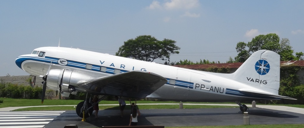

Originally built as NC16009 for American Airlines, this was the FIRST DC-3. In 1959 her aft fuselage was damaged by a C-46 that had a gear collapse on landing in Sao Paulo, Brazil. The aft fuselage from a C-47 was grafted on and she continued service. Now on display in Puerto Alegre, Brazil.
