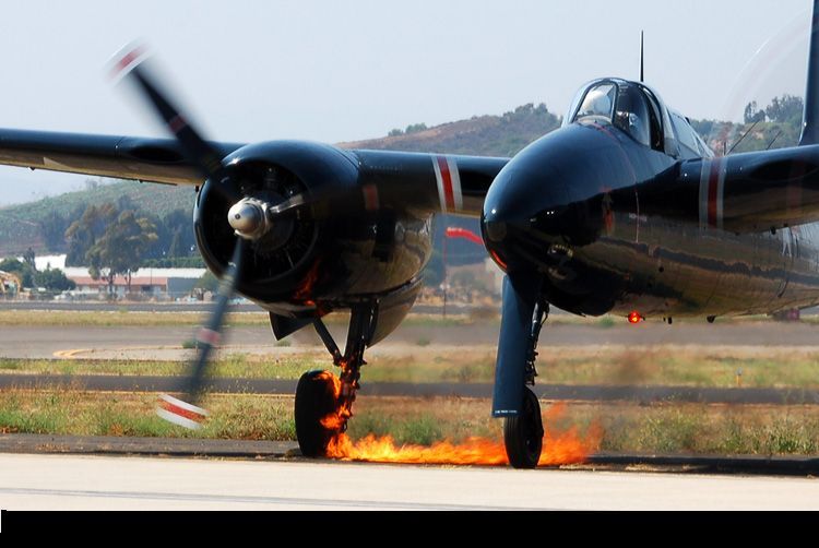

Pretty typical example of a too-rich mixture burning off in the exhaust. Once the excess is out of the cylinders, the engine fires and blows out the fire.
The Tigercat is a tricky situation. A lot of radials manage to leak fuel during starting or dump any excess overboard after a starting attempt. If this then ignites you end up with something that you cannot sort out from the cockpit. I've seen this happen on a B-25 as well.
