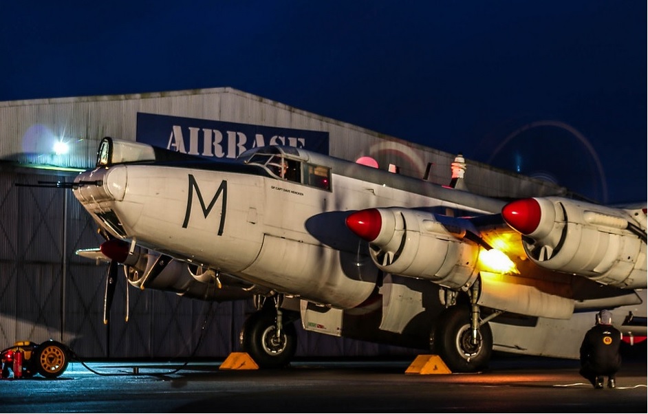

PostPosted: Thu Oct 01, 2020 3:08 pm
Joined: Sun May 09, 2004 9:10 am
Posts: 165
Location: Chesterfield, Derbyshire, UK
Happens occasionally on ours, especially to some that seem to think the primer button is like running a choke on a car. The worst one we had was when a gust of wind licked the flame under the cowling on one of the outboard engines and lit the fuel draining out the intake.
More often than not its a just brief flame, then gone again.
