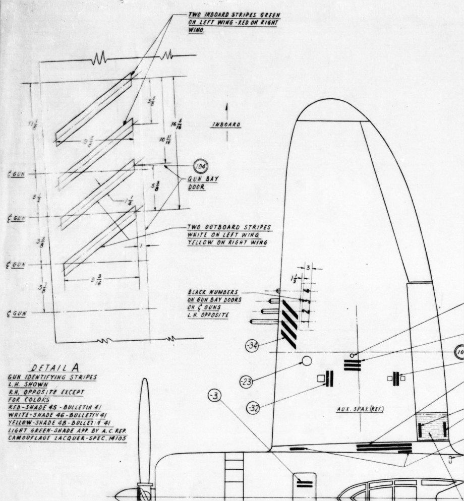

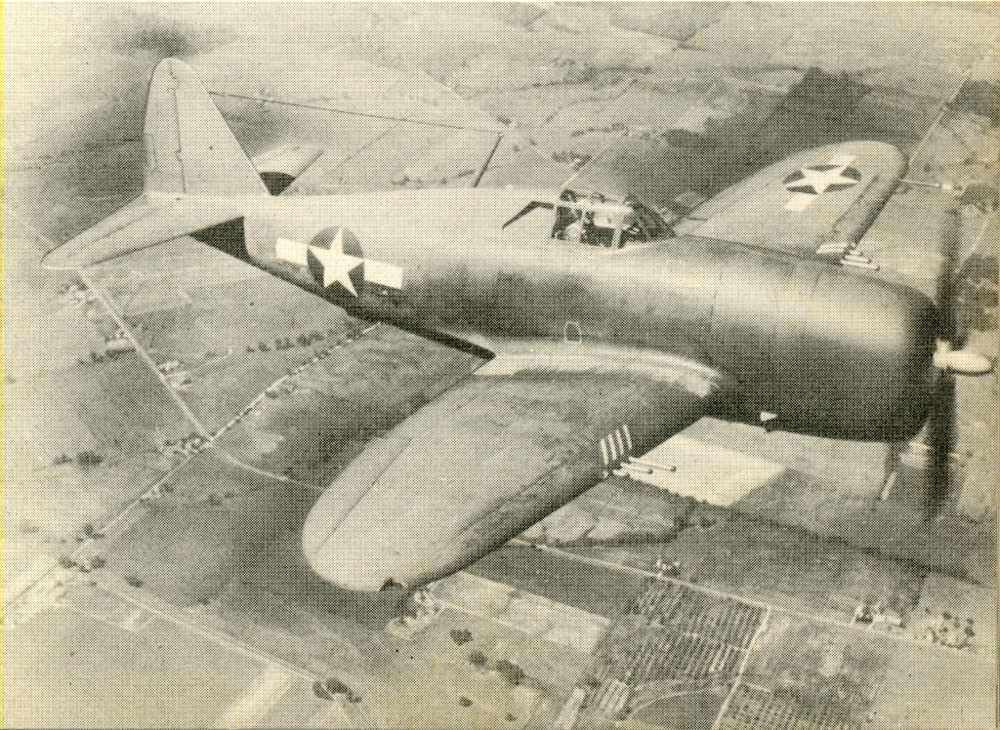

What is the purpose of the white lines on the leading edge of the wing near the guns?
(Source: Preflight Study Manual for Civil Air Patrol Cadets (Headquarters AAF, Office of Flying Safety, n.d.) 3-7.)
The explanations I have come up with or heard so far is that they are either for boresighting the guns, measuring wind drift angle, or bomb aiming.

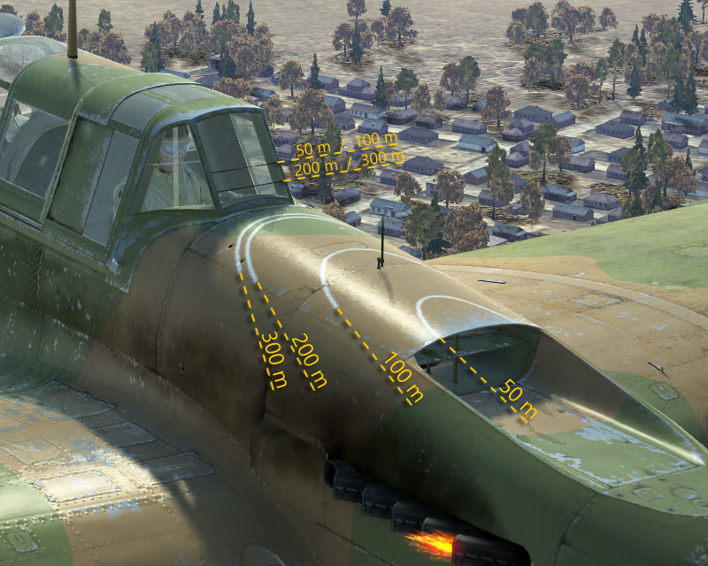

...the Il-2 has level bombing lines painted on the engine cowling...

...and the B5N has similar lines on the tail as well as the nose.

Some P-47s apparently also had flap angle lines painted on the trailing edge of the wing, so maybe that's where the idea came from.
(Source: RCUniverse.com)
EDIT (22-04-05): It seems that the above picture may have been taken for use as a recognition slide, as a different picture of what appears to be the same P-47 can be found in a set digitized by the State Archives of North Carolina.

these lines are for guns identification, they were on P47B number 7 up to 47 only. colors were white, yellow, red & green in add
Wow, that was a quick answer! Thanks!
