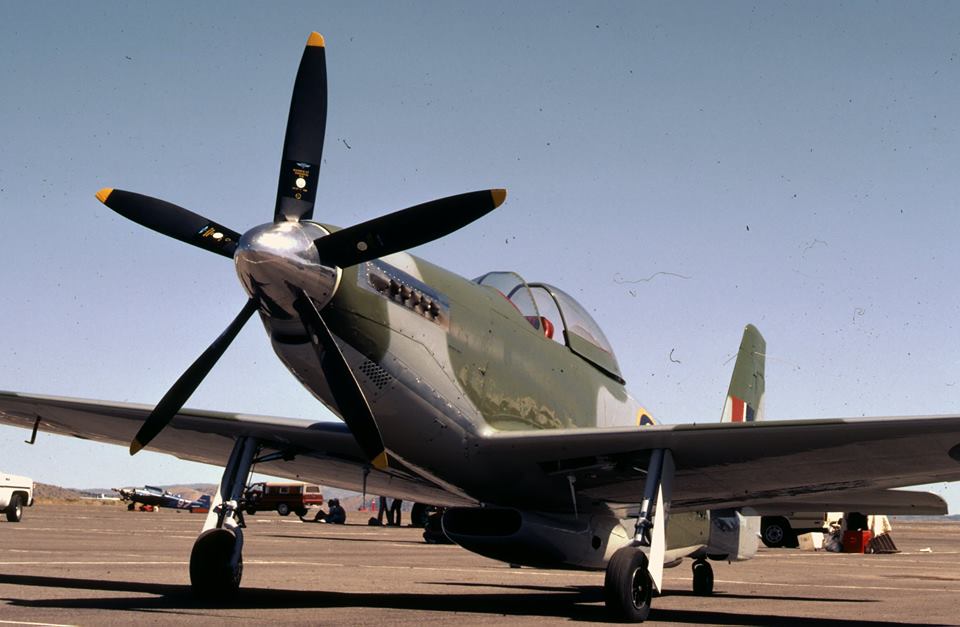

not a real one, but still fun to look at..... 8)
pop2
This is the Whittington P-51H with a five blade wooden Rotol propeller.
